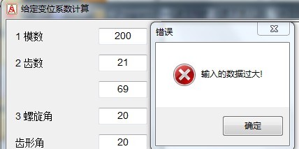

如果输入:
mn=input(5, 0.1 to 100)
表示:
mn 的默认值为5,取值范围为:0.1  到 100,
当你在窗口面里输入的值不在:0.1 到 100 之间时会报错,如下图:
点确定后,模数输入框变红了。

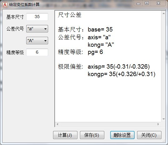

选择框的使用:
尺寸公差
基本尺寸:        base=input(35,1 to 500)
公差代号:        axis=input("a","b","c","cd","d","e","ef","f","fg","g","h","js","j","k","m","n","p","r","s","t","u","v","x","y","z","za","zb","zc")
kong=input("A","B","C","CD","D","E","EF","F","FG","G","H","JS","J","K","M","N","P","R","S","T","U","V","X","Y","Z","ZA","ZB","ZC")
精度等级:        pg=input(6)
极限偏差:        axisp=size(base axis pg)
                kongp=size(base kong pg)
