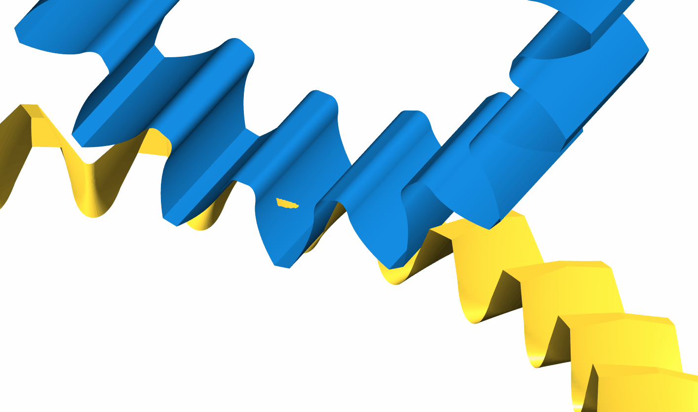

斜齿轮与直齿条的啮合,是线接触而不是点接触,Why?这个问题仔细想想就能明白!
 楼主| 发表于 2023-1-28 07:43 | 显示全部楼层

空间交错的斜齿轮与齿条啮合,虽然仍是线接触,但是齿面间相对滑动速度增加了一个轴向分量,也就是相对滑动速度增加了。

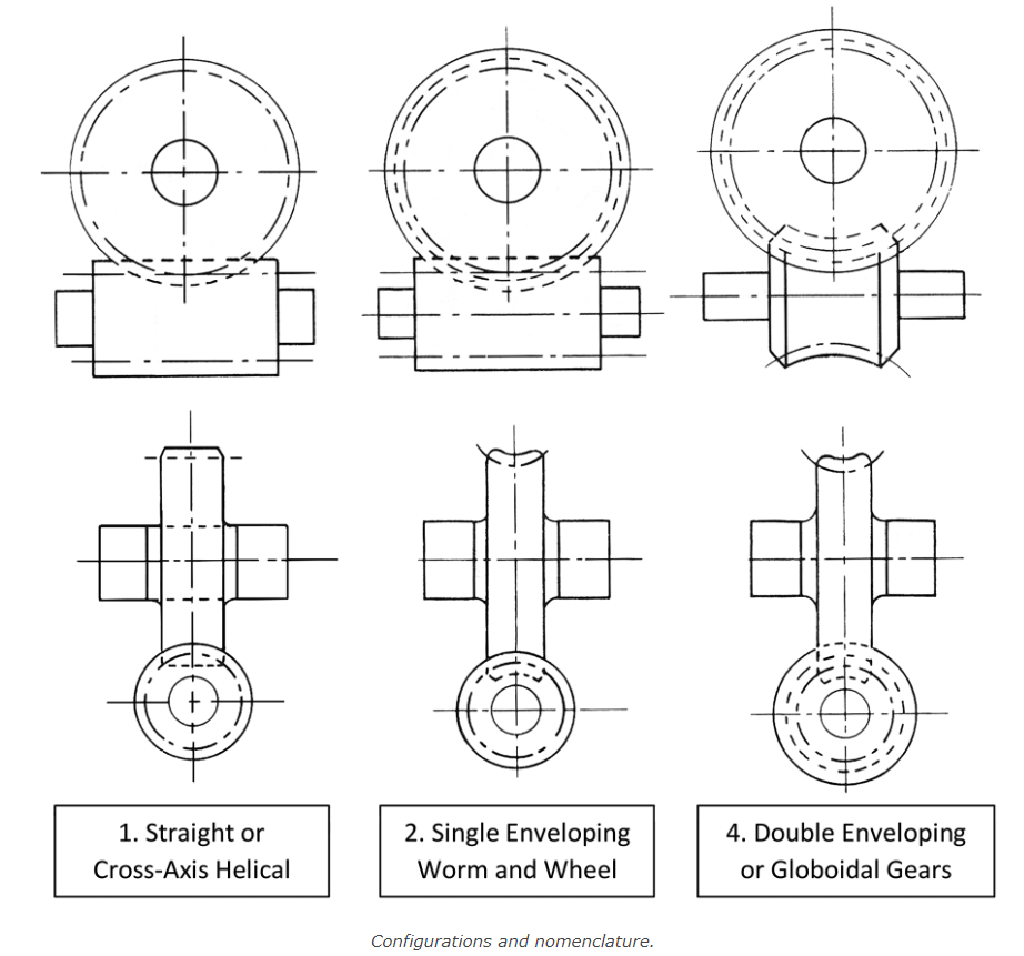

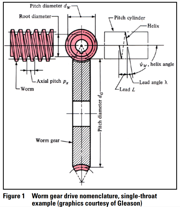

Worm Gear Generation and their Manufacturing Tools
The question will be answered considering the different possibilities in profile form, kind of mesh, and type of tools. Figure 1 contains the general nomenclature used to define the geometry parameters.
Worm gear drives can be separated in three categories:
Case A. Crossed helical worm gear drives
Case B. Cylindrical worm gear drives
Case C. Double-enveloping worm gear drives
