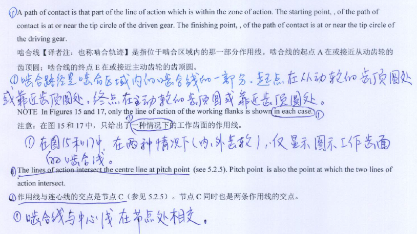

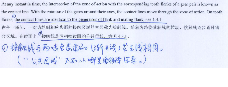

发表于 2014-4-30 19:22 | 显示全部楼层
mrmrw 发表于 2014-4-3 15:44
5.4.2 Plane of action, zone of action, contact line 5.4.2啮合平面,啮合区域,接触线The plane of acti ...
谢谢指点!!  发表于 2014-5-3 08:01
