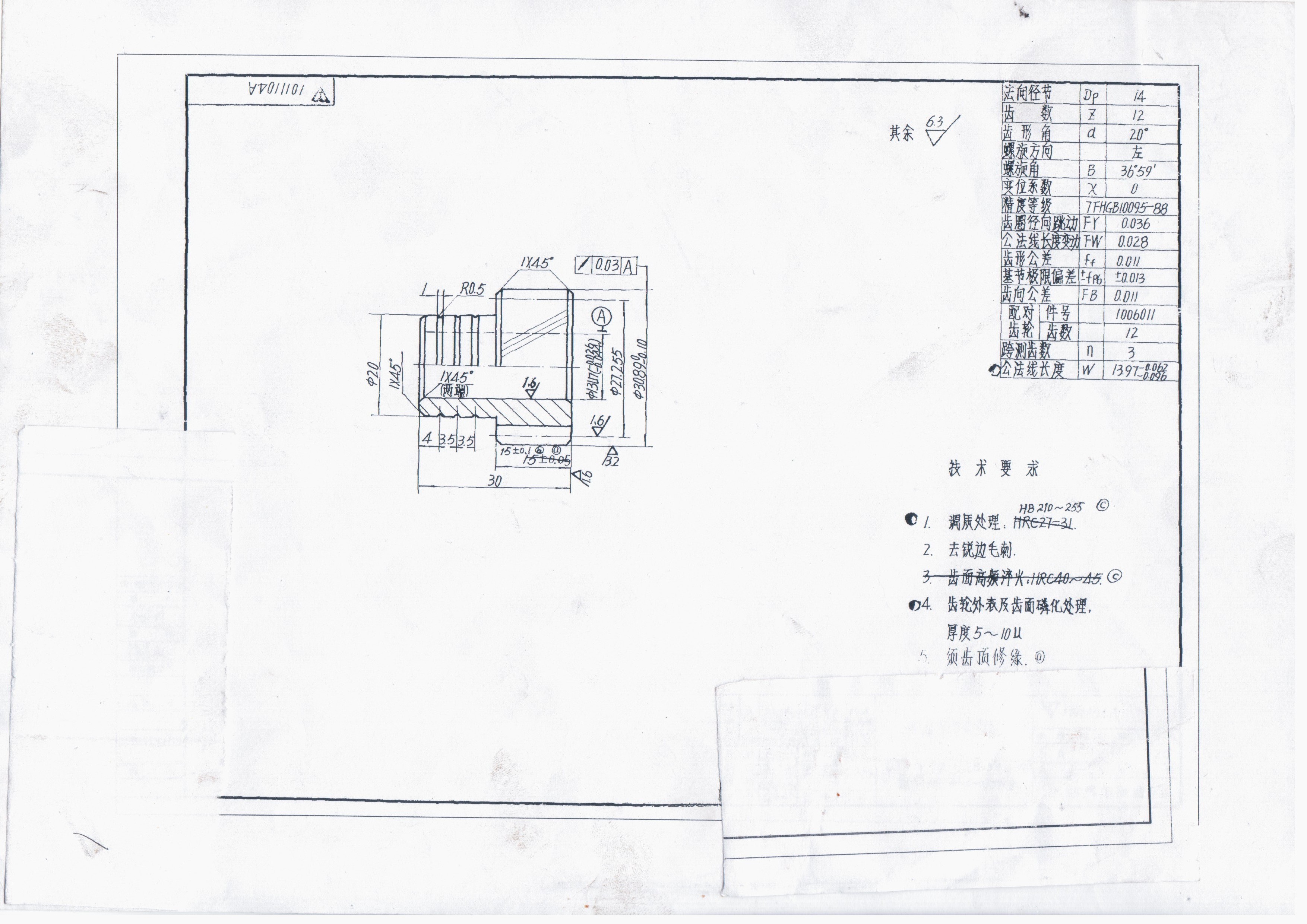

我现在有一个斜齿轮如图,想要配一个齿轮
中心距要求在60到65之间,希望哪位大师帮忙设计一个[attachimg]49824

发表于 2011-11-5 14:50 | 显示全部楼层
你能看出啥参数?

发表于 2011-11-5 17:26 | 显示全部楼层
a - 60    z2 41
a=62.5  z2 43
a=65     z2 45

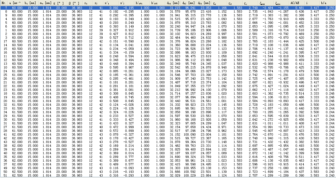

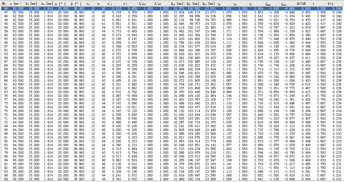

发表于 2011-11-5 20:01 | 显示全部楼层
要求不详,答案很多,你自己选选吧!

发表于 2011-11-5 23:46 | 显示全部楼层
Gear Date Caculation
        Name                Pinion        Wheel        remark
        Number Of Teeth        z        12        43
        Normal Module         mn        1.814
        Normal Pressure Angle        αn        20.000
        Helix Angle                 β             36.983
        Addendum Modification Factor         xn        0.00         -0.08
        Center Distance        a        62.500
        Face Width         b        20.000
        Gear Hand        Hand        L        R
        Ratio        u        3.583
        Working Transverse Pressure Angle        αwt         24.599
        Reference Diameter         d        27.250         97.647
        Tip Diameter         da        30.890         100.000
        Effective Tip Diameter         dFa        30.490         99.600
        Root Diameter         df        21.820         91.000
        Base Diameter         db        24.798         88.858
        Normal Base Pitch         pbn        5.355         5.355
        Normal Thickness          sn        2.850         2.750
        Thickness At dae         sn ae        1.507         2.032
        Tip Thickness                 1.009         1.554
        Number Of Teeth For Chordal Span Test        k        3         3         input
        Chordal Span        Wk        13.963         15.355
        Root Form Diameter         dFf
        SAP Diameter                25.777         95.246
        SAP Rolling Distance                 3.520         17.146
        Total Contact Ratio        εγ        2.935
        Transverse Contact Ratio        εα        0.824
        Axial Contact Ratio        εβ        2.111
        Sliding Factor At Tooth Tip        Kga
        Minimum Normal Backlash         jbn        0.128
