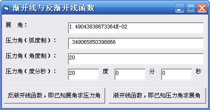

[软件] 渐开线函数与反渐开线函数计算

看了图片,非常不错,谢谢分享!

源程序:
1:        val1=4.2750184180222
2:        middle=45
3:        pg=13
4:        min=0
5:        max=90
6:        val2=inv(middle)= 0.2146018366026
7:        i=0
8:        wcycle(abs(val2-val1)>(1/10^pg))
9:                if(val2>val1)
10:                        max=middle= 80.000000001455
11:                else
12:                        min=middle= 79.999999998836
13:                end if
14:                middle=(min+max)/2= 80.0000000001455
15:                val2=inv(middle)= 4.2750184181039
16:                i=i+1= 35
17:                if(i>100)
18:                        exit wcycle
19:                end if
20:        end wcycle
21:        angle=middle= 80.0000000001455

能告诉我是用什么软件编程的吗?是怎么编程的?能告诉我吗,我也想自己编程一些小软件自己用!
 楼主| 发表于 2011-3-26 12:18 | 显示全部楼层
回复 qiuzhishihui 的帖子
你好,我是用vb6.0编的,原理和speed_long 的一样,用二分法
