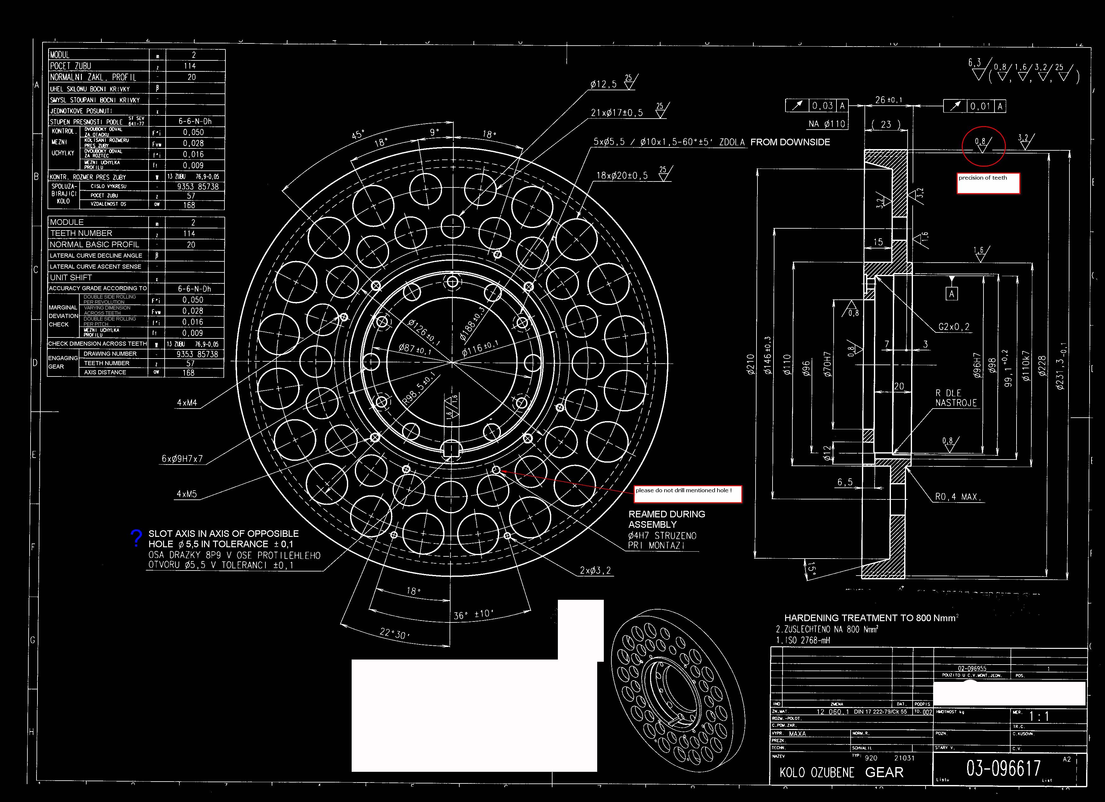

下面是一德国客户对我的齿轮样品的检验报告,我实在看不懂,现在请教高人指点,主要就是后面加粗的e-k的这部分,请帮助翻译。
另外,如图所示,左下方的蓝色问号我实在不懂。请高人指教。谢谢。
还有的话,请告知这个齿轮的技术要求算高还是一般的?如果能报个大概的价格非常感谢,如果能推荐几家擅长此产品的工厂,就更好了。
谢谢。
INSPECTION REPORT - toothed wheel 02096955
a)dimension - diameter 110k7 - too big
b)dimension - diameter 9H7 - to small
c)dimension - diameter 70H7 - to small
d)dimension - diameter 96H7 - to small
a,b,c,d - expected reason - due to nickeling (nickel-coating)
d)"loose" winding M5
e)the two-side-tip for spacing (span) 0,016 mm has been not achieved - 0,025 measured - it is noisy
f)wry sparing 8P9 up to 0,12 mm
g)axe of the sparing 8P9 in the axe of the opposite inlet - diameter 5,5 mm with acceptable tolerance +/- 0,1mm - has been not achieved - 0,17mm measured
h)tolerance +/- 5' of inlets - diameter 5,5 mm - has been not achieved - up to 12' measured out.
i)we were not able to measure out the casting 0,03 A and 0,01 A. The reason. The close-inlet - diameter 96H7
j)the fray at the sparing 8P9
k)wheels are nickeled
