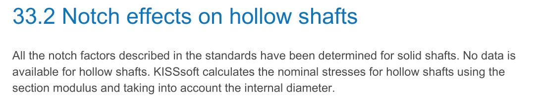

KISSSOFT轴强度计算有内孔的轴如何定义缺口系数
发表于 2022-2-11 09:17 | 显示全部楼层 |阅读模式
提示是:For shaft with internal diameter the notch factors are not available.None of the known calculation methods produces reliable data. It is proposed to use the data for the full shaft and to judge the results conservatively.
发表于 2022-3-4 16:16 | 显示全部楼层
目前还没有针对带内孔的轴定义缺口系数,如果需要准确结果的话,建议用有限元法计算一下疲劳。
