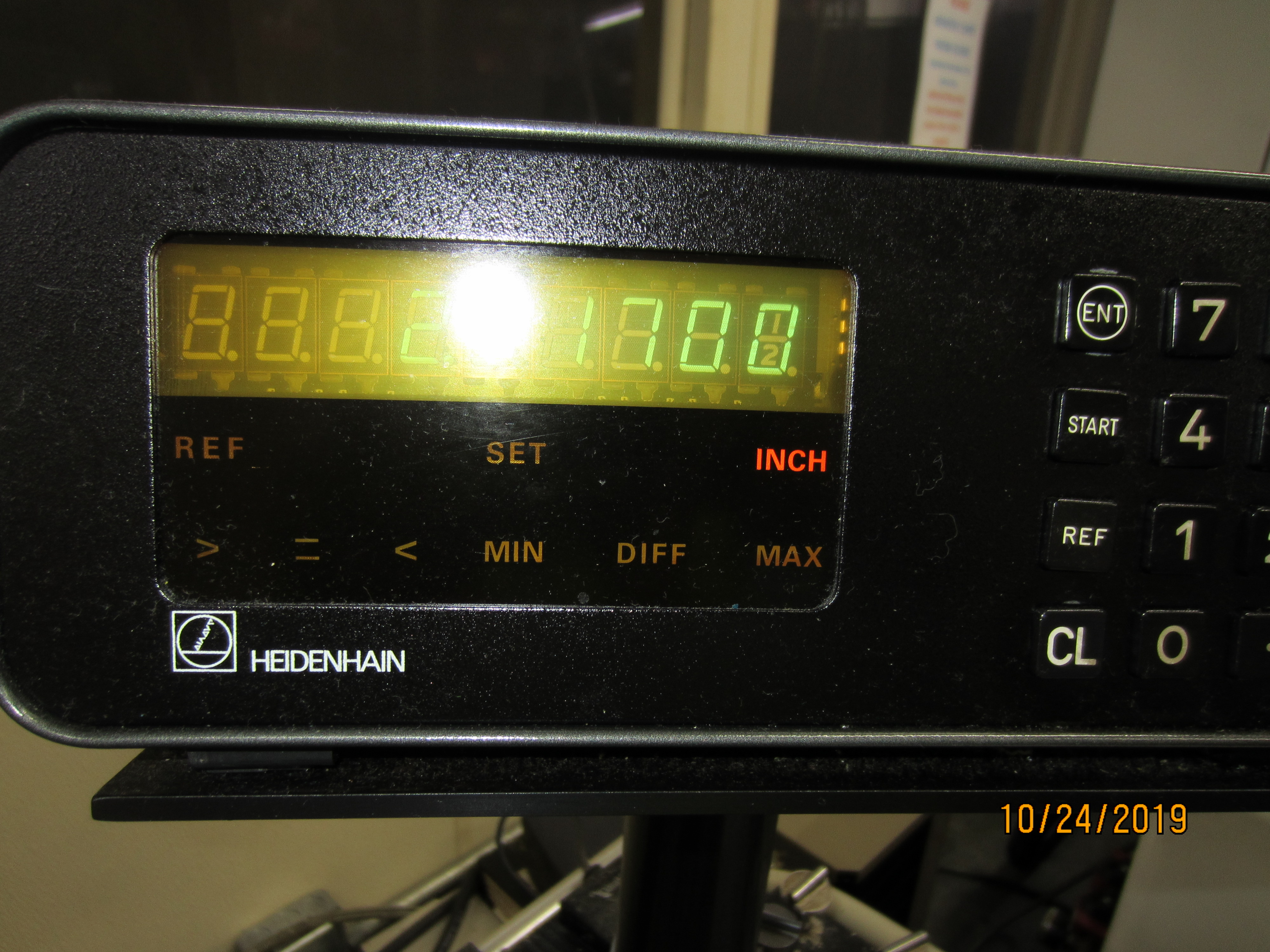

1. The first photo shows the master reading 2.3170. 第一个图片显示标准封样读数是
2.317

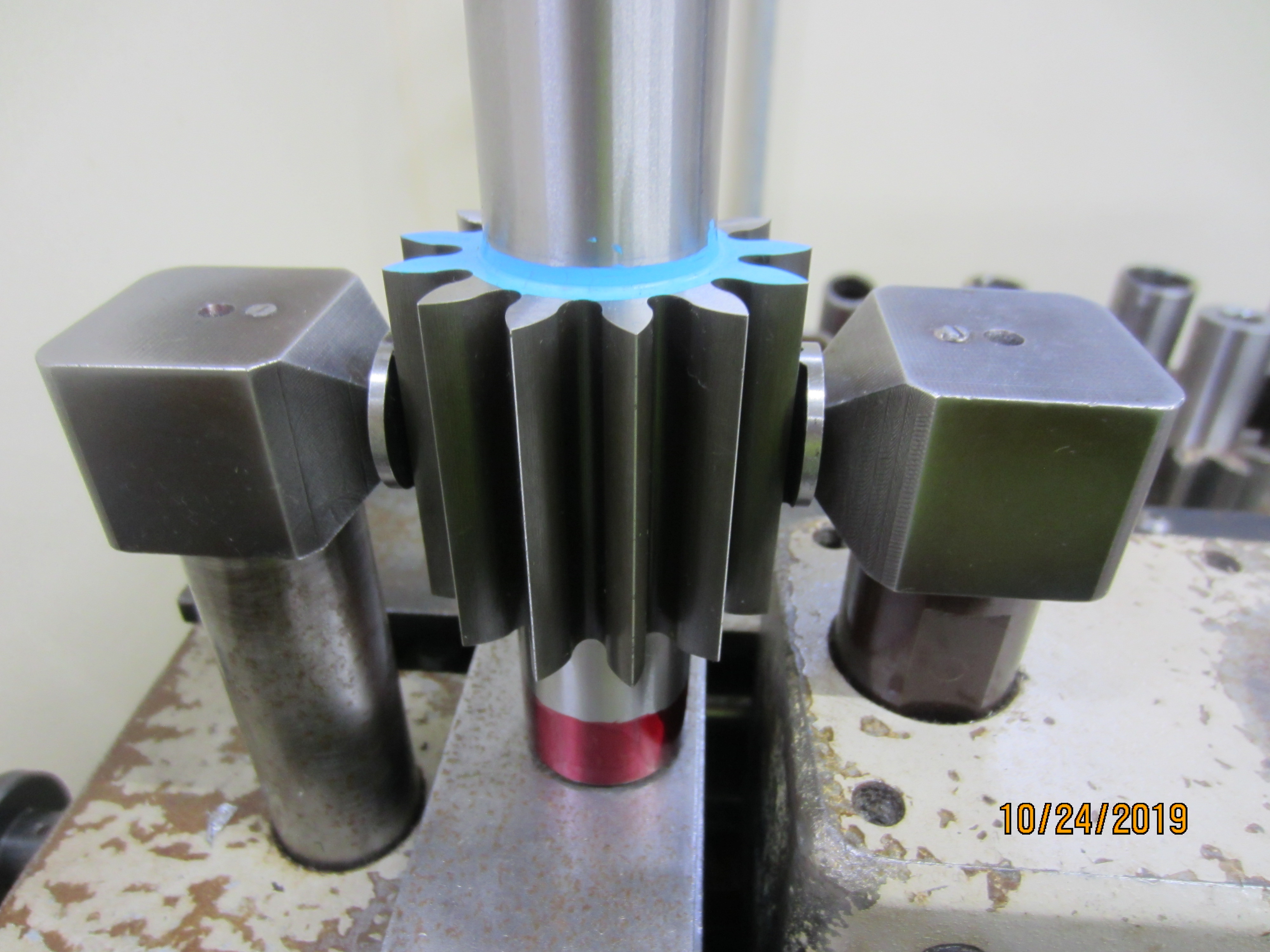

2. Second photo shows the master gear in the ITW machine. 第二个图片是封样在德国海
德汉光栅仪器测量位置

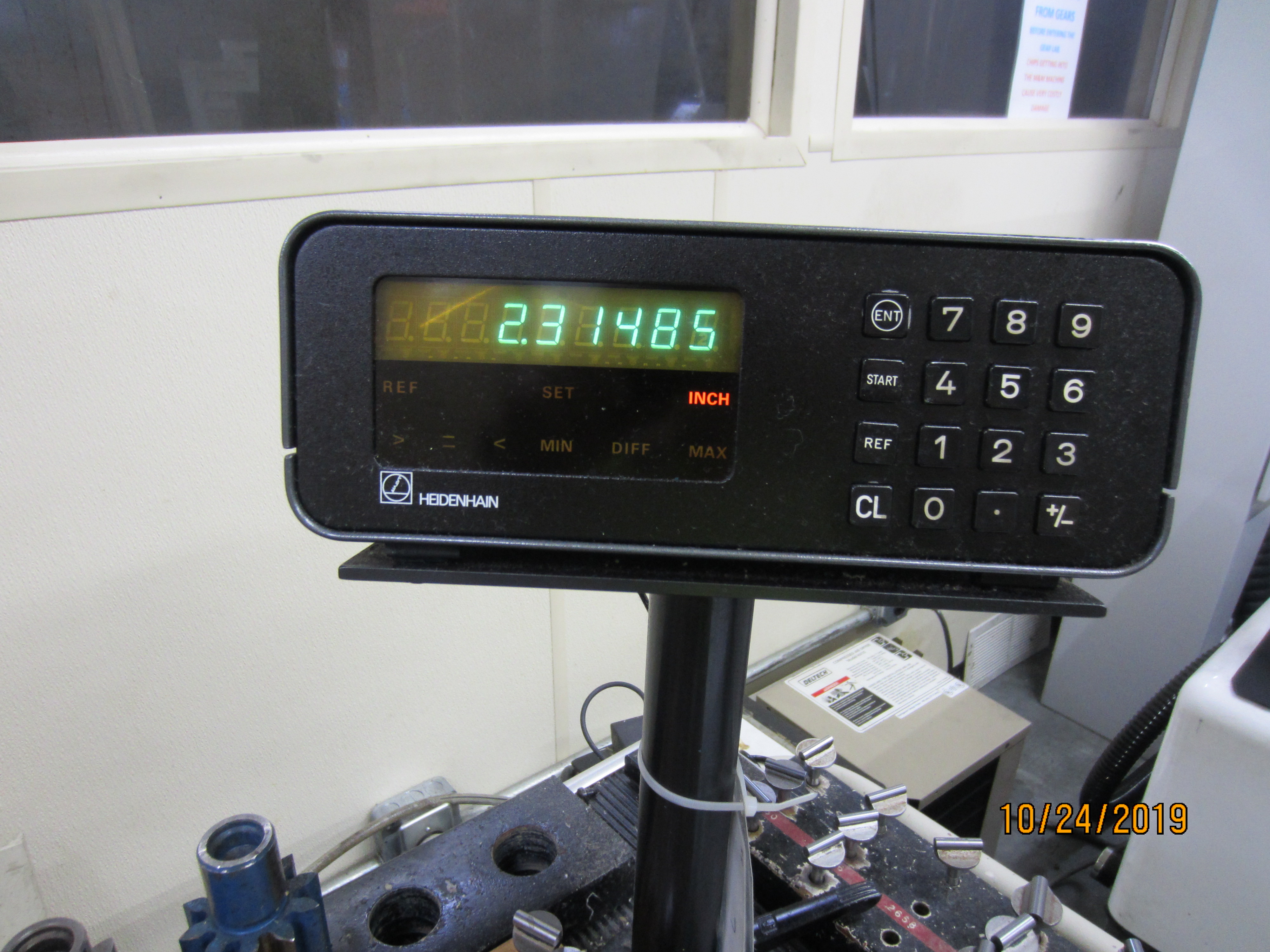

3. Third photo shows the actual size of one of their gears. 2.3148. Spec. is
2.3160-2.3180.第三个图片显示的齿轮实际测量尺寸是2.3148,图纸要求是2.316-2.318

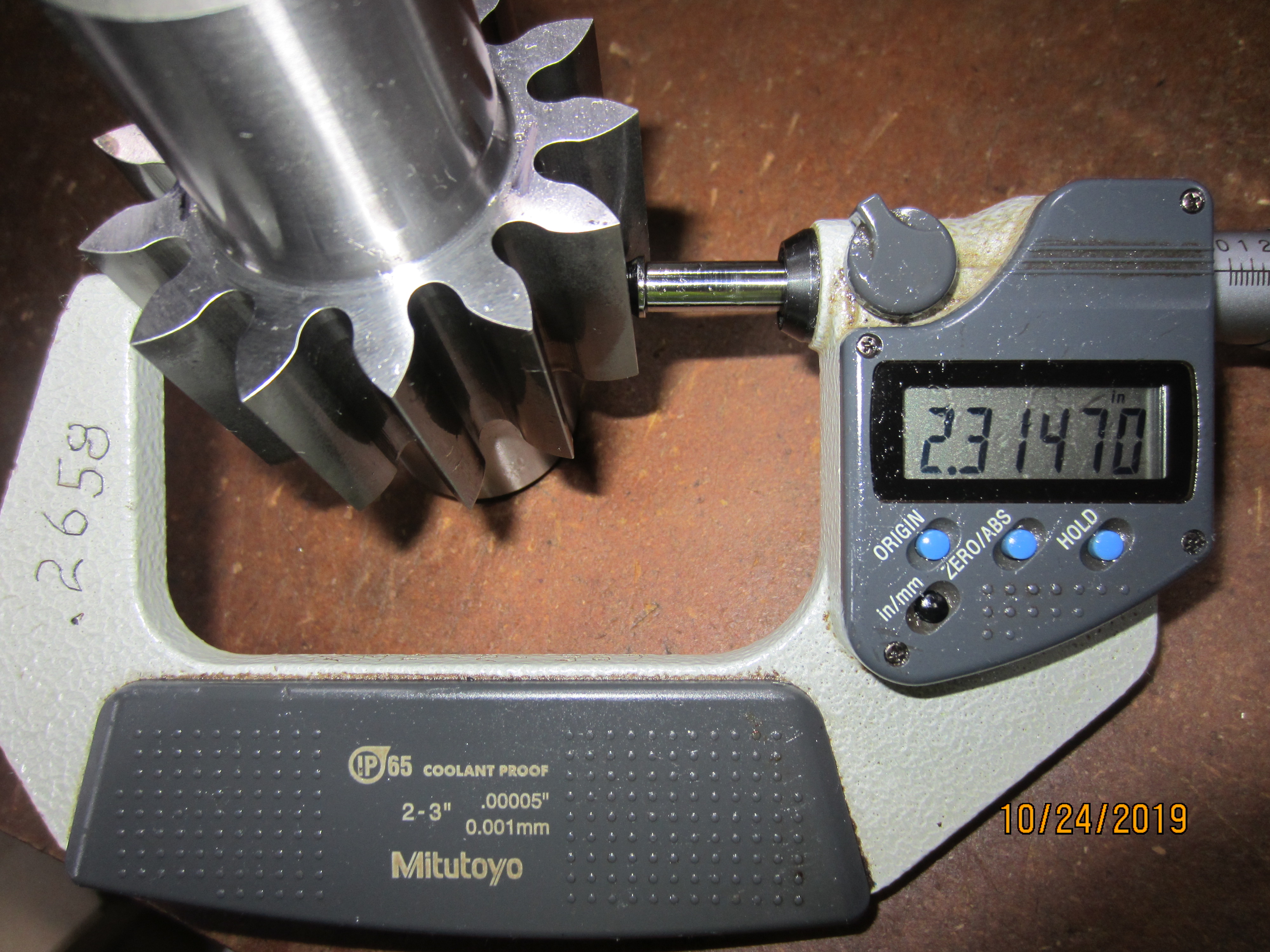

4. Fourth photo shows the gear being measured on the ITW over-the-pin dimension
(OPD). 第四个图片显示被测齿轮在上述设备跨棒检测

2
2
3
3
4
4
5
5
