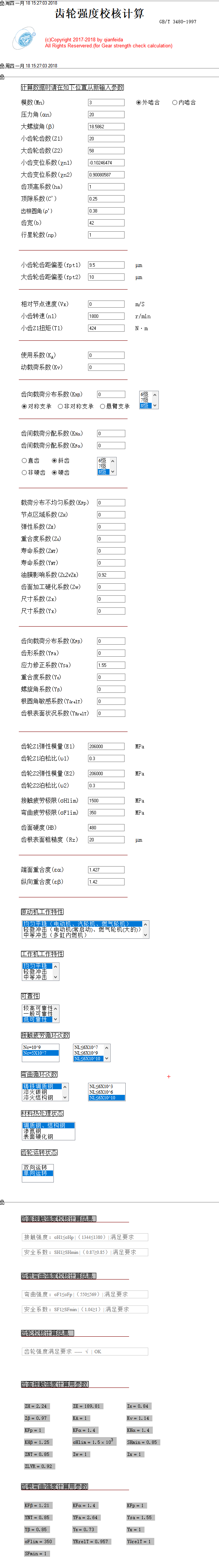

求助:这样一组参数能帮忙优化下嘛
发表于 2018-9-6 20:29 | 显示全部楼层
好像只能满足单向传动
发表于 2018-9-7 08:48 | 显示全部楼层
freefreemen 发表于 2018-9-6 20:29
好像只能满足单向传动
类似条件下做个对比
外啮合
mn=3
Z1=20        Z2=58
xn1=-0.102465             xn2=0.900806
ha*=1.0
C*=0.25
hfp*=1.25
ρfp*=0.38
αn=20
β=18.5862
b=42 mm
a=125.7 mm
精度:8
P=80
n1=1800
50000小时
润滑油粘度:220
σHlim1=1500          σHlim2=1500
σFlim1=350           σFlim2=350
Rz=20.0μm
Rz1=6.3μm            Rz2=6.3μm
允许少量点蚀
对称布置(不修形)    轴承跨距84mm
装配时不作检验调整
硬齿硬度大于470HBS
****接触****
T1=424.4 N.m
Ft=13408.85
Fr=5148.966
Fx=4508.982
Fn=15054.568
V=5.966024
mred=0.011655
ZH=2.241554
ZE=189.8117
Zε=0.837155
Zβ=1.027144
ZB=1.0
ZD=1.0
KA=1.0
Kv=1.043075
KHβ=1.526804
KHα=1.14785
C'=13.322541
Cγ=17.587918
nE1=18547.846957
N=0.097046
Znt1=0.887755             Znt2=0.957058
ZL1=1.019997        ZL2=1.019997
Zv1=0.986837        Zv2=0.986837
Zr1=0.94128        Zr2=0.94128
Zw=1.0
Zx=0.9997
σHG1=1261.296MPa        σHG2=1359.76MPa
σH1=1288.24MPa        σH2=1288.24MPa
SH1=0.9791             SH2=1.0555
****弯曲****
Yst=2.0
YF1=1.727464             YF2=1.073532
Ys1=1.739511             Ys2=2.507823
Ysg1=1.739511             Ysg2=2.507823
YFa1=2.84399             YFa2=1.987906
Ysa1=1.531005             Ysa2=1.9567
Yε=0.72847
Yβ=0.845115
Ynt1=0.860785             Ynt2=0.879311
KFβ=1.43033
KFα=1.14785
Yδrelt=0.990873             Yδrelt2=1.005394
YRrelt1=0.956738             YRrelt2=0.956738
Yx1=1.0             Yx2=1.0
YB=1.0
σFG1=571.220MPa             σFG2=592.065MPa
σF1=462.818MPa             σF2=414.653MPa
SF1=1.2342             SF2=1.4279
 楼主| 发表于 2018-9-7 13:49 | 显示全部楼层
好像只能满足单向传动
单向运转就够了,谢谢大佬
submariner 发表于 2018-9-7 08:48
类似条件下做个对比
外啮合
谢谢版主
