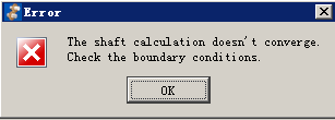

2
The shaft calculation doesn't converge.
Check the boundary conditions.

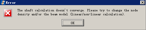

3
3
The shaft calculation doesn't converge. Please try to change the node density and/or the beam model (linear/non-linear calculation).

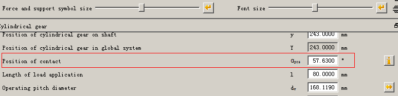

2.意外中改变如下图(与z6r啮合的)z5(gp3r)齿轮参数中的齿轮位置时,角度设置到76度以上就不会出现错误,不知是什么原因。

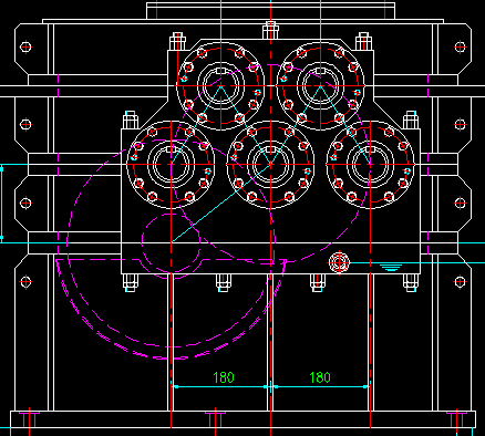

另外附上齿轮箱结构示意图:
6
6
请大家帮忙看看是哪里出的问题,多谢!
