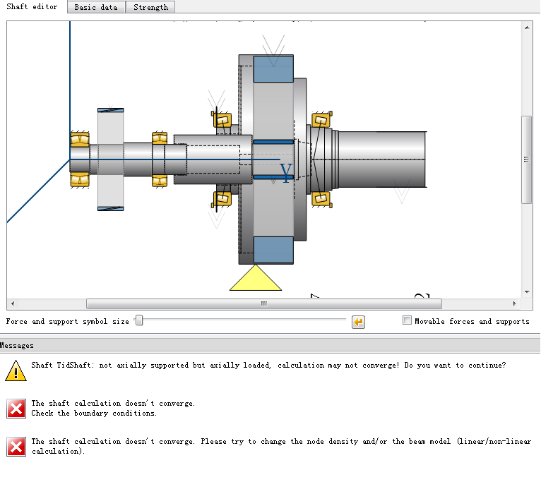

在进行详细建模后,对行星销等运行计算,经常会遇到两个错误:
"The shaft calculation doesn't  converge, check the boundary condition."
" The shaft calculation doesn't  converge . Please try to change the nodedensity and/or the beam model(linear/nonlinear calculation )."
另外,在将太阳轮轴与中间轴进行连接时,中间的“connection,general”怎么设置,经常收到提醒:
"shaft TidShaft: not axially supported but axiallyloaded, calculation may not converge! Do you want to continue?"
望大侠们不吝赐教,先拜谢了!
发表于 2015-2-2 16:27 | 显示全部楼层
边界条件不对,
发表于 2015-2-2 16:46 | 显示全部楼层
估计是你对机构不够了解,有干涉(重复定位)。图片中齿轮输入轴两端已经有了两轴承,直接联结到行星输入端有无花键?
发表于 2015-3-7 16:47 | 显示全部楼层
你这是“运动学”没有设置合理,许重新检查定义
发表于 2015-3-13 20:19 | 显示全部楼层
今天也碰到过了,后来发现轴承定位错了
