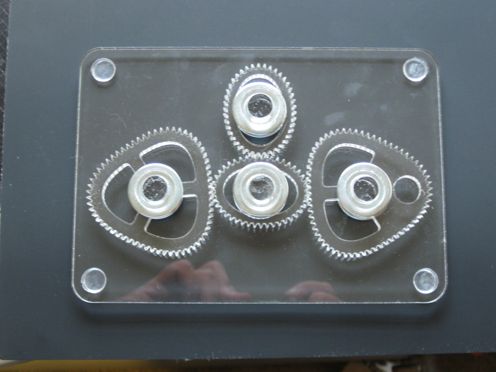

非圆齿轮用什么机床加工呢?
发表于 2010-6-12 22:00 | 显示全部楼层
有椭圆齿轮的数据吗
 楼主| 发表于 2010-6-24 14:28 | 显示全部楼层
数据有的。

哇,太有才了,,这齿轮在转的时候速度是不是不一样呀?
 楼主| 发表于 2010-8-27 13:11 | 显示全部楼层
又有一老外,美国的,有激光切割机,加工一付.
The laser has a maximum resolution of 1200 DPI... or about 0.02mm, the beam width is about 0.1 mm wide... but in reality it fluctuates about .2mm
The set of gears, the plastic base, and the rings to hold the gears took about 20 minutes. Cutting the 12.7mm (1/2 inch) rod into 4 pieces took another 2 minutes.
