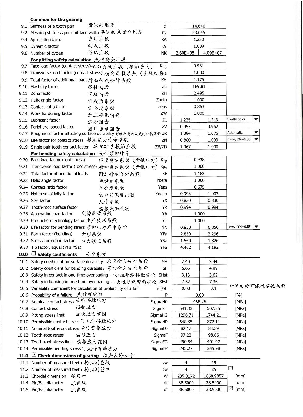

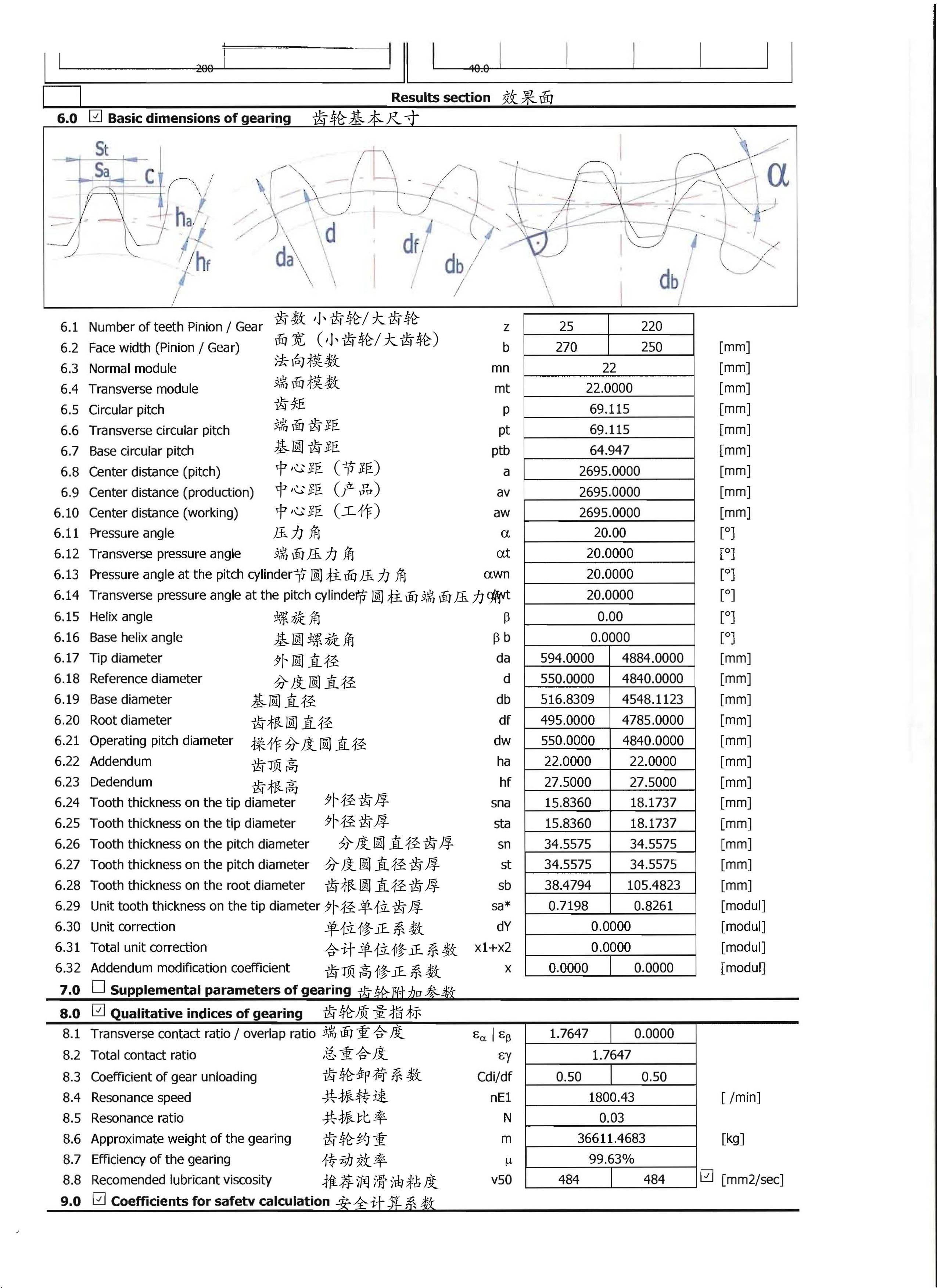

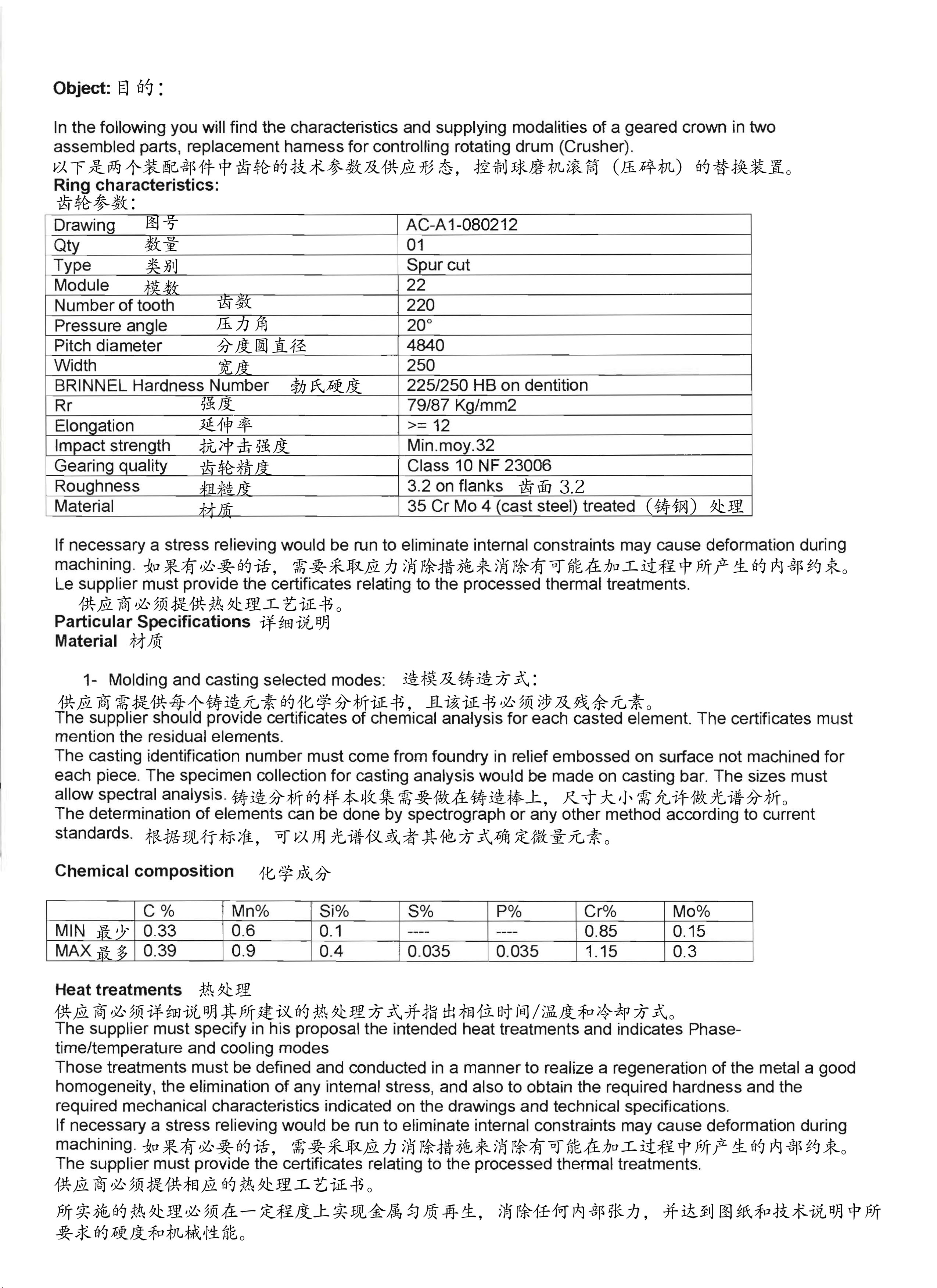

刚进齿轮行业,最近刚翻译了一个英文齿轮规格,请高手指教,希望获得进步,一起努力一起进步!
Specifications for Geared crown and Pinion - 1-4.jpg Specifications for Geared crown and Pinion - 1-3.jpg Specifications for Geared crown and Pinion - 1-2.jpg
 楼主| 发表于 2012-3-12 13:40 | 显示全部楼层
Specifications for Geared crown and Pinion - 1-7.jpg Specifications for Geared crown and Pinion - 1-6.jpg Specifications for Geared crown and Pinion - 1-5.jpg
 楼主| 发表于 2012-3-12 13:56 | 显示全部楼层
其中有两张重复  呵呵 不好意思哈 总是弄不掉  大家帮帮忙
