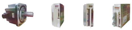

日本安川伺服电机及驱动器
Japanese Yaskawa brand servo-motor and driver
