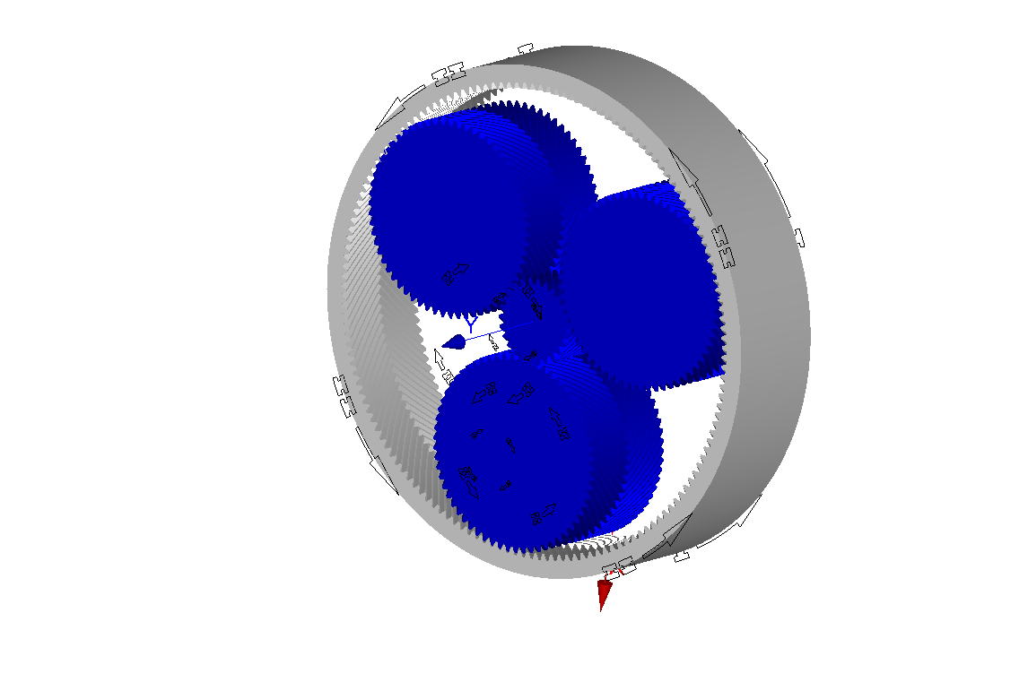

有关人字齿行星齿轮建模计算问题
发表于 2013-12-3 13:10 | 显示全部楼层 |阅读模式
错误提示
No contact analysis can be performed for double helical gearings.If this simplified method is not sufficiently accurate,
you can use the KISSsys system to perform a correct contact analysis for double helical gearings at any time by
entering each half of the gear into the KISSsys model as a separate item.
The double helical gearing is then handled as a normal helical toothed gear.
是不是算不了接触分析????
发表于 2013-12-6 19:32 | 显示全部楼层
你这个是用在哪个里面的?? 我想您不用KISSsys 在KISSsoft里面也可以的吧??
